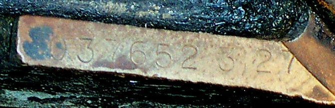

<<He also sent me a shot of a tag or ID - I forget exactly which - that proved it was a 3.27. >>
 The ratio is Stamped on the case , driver side , on a machined flat in front of the axle outer tube flange mount.
 If it had a Tag on it , it is more likely not a ratio tag, but a Posi Tag..check it out cuz they take a special posi fluid.
If I remember correctly , the posi is the one with the added cooling tube. These hit the chassis if not capped.
 I have some in the barn and will take a closer look to be sure.....

As Joe said, the earlier 111, 3.5 had the 3,46 and 3,69. I believe the Sedan was 3,46  and the Coupe was  either/option.
 The 108 , 4.5s were 3,27 . I think the 3:23 is just a typo ??

Actually the 3.23 figure comes directly out of the Factory "Technical Data" booklet (1972). In any case the difference between 3.23 ratio and 3.27 in insignificant.

Regarding the ration on W108 4.5's. My materials indicated that it was a 3.23 ratio, too. However, others disagreed. Attached is a picture of the numbers stamped on mine. Sure seems to be 3.27.
