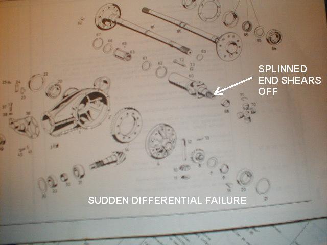

Sorry to hear about the bad luck.  It sounds like the splinned univeral in the differential sheared. These can be changed out, but the differential will need to be opened up and removal is probably best.
Download Attachment: SUDDEN DIFFERENTIAL FAILURE.JPG
34.61 KB
The new part is very expensive. A good used differential is a good option. Good used univeral units can also be had. Most W111, W112, W108 sedans and coupes of the era had this type of differential. The 3.75 ratio of the 230-SL may be a little more difficult to find. However 4.08, 3.96, 3.69 and 3.27 are a lot more common. These will also have disc brakes on the rear also.

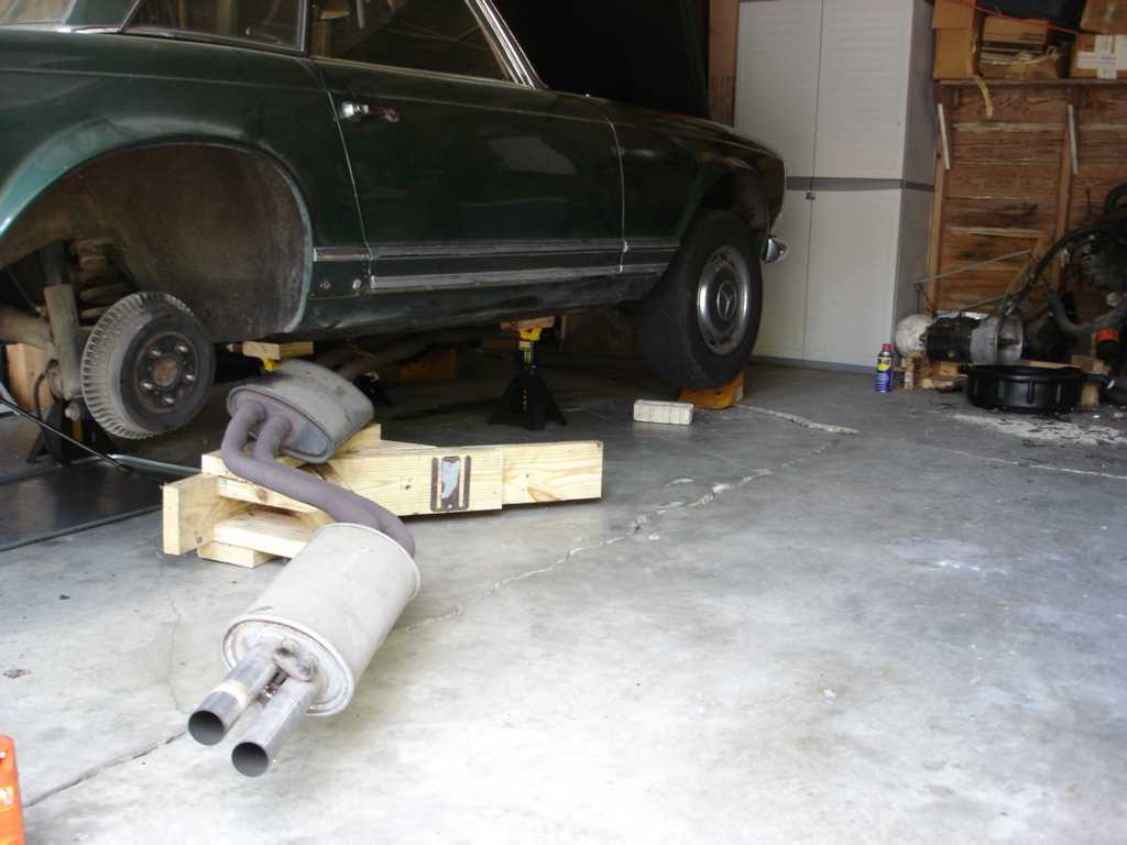

Try raising the car just on the right side to remove the exhaust!
After exhaust removal, jack up the car on all corners. You will need to block up the vehicle in the rear and leave access to the rear suspension for removal. Do not allow the right rear axle to hinge down hard against it's casting which can crack! Prevent this by removing the transverse compensator spring first.

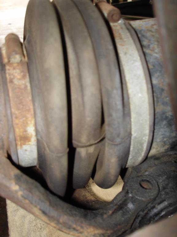

Check your new unit by unclamping the larger boot clamp and inspecting the thin lip of the casting for cracks.
Yes you should closely inspect the axel boot. Replace it if at all questionalble.

Alright. I was able to remove the exhaust and rotate it to the right, without removing it entirely from the car. quite amusing actually. It seems my exhaust seals either disintegrated, or were never installed in the first place (at the exhaust manifold header). In any case, I shall install new ones. I disconnected the e-brake cables and brake hoses. I surveyed the damage, and it looks as if some seal exploded in there! From what I understand, here are the recommended steps in order (even though they somewhat differ from the Haynes and BBB instructions):

Download Attachment: exhaust.jpg

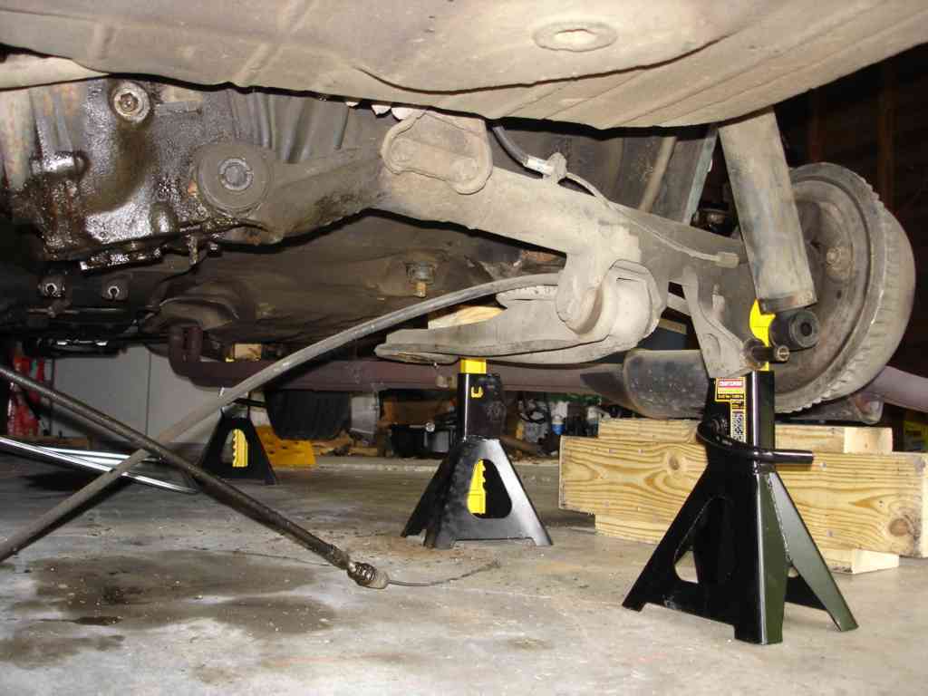

I leave the rear shocks attached until until the right axle half is supported with a floor hjack or such. This will prevent the axle from hinging down hard against it's casting.  Let the rear axles hang down releaving pressure on the compensator spring. Remove the rear compensator spring next. Removal of the compensator spring should be done with a spring compressor (compressed springs are very dangerous).
You can support the axle halves easily with a floor jack and disconnect the trailing arms and remove the rear springs (no spring compressor needed for these).

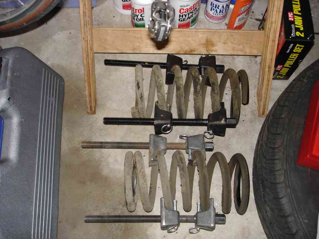

I was able to remove the springs and shocks yesterday (rear axles are supported). Having lowered the axles quite bit, I was still unable to get my spring compressor jaws into the compensating spring. I'm now considering making my own tool... but does anyone have a recommendation on a commercially available spring compressor that will fit?
Download Attachment: springs.jpg
55.05 KB
Download Attachment: axle_support.jpg
56.4 KB

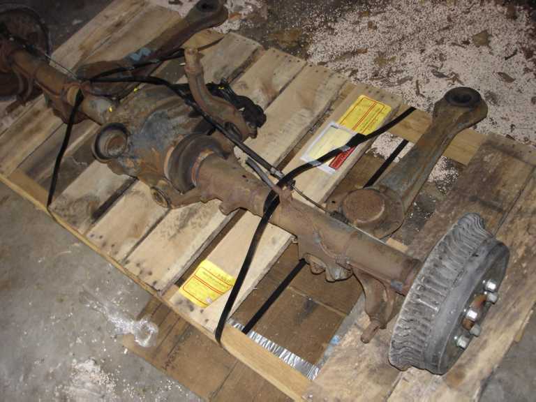

My new (to me at least) differential arrived this afternoon, and I just completed a photoshoot: I have a ton of questions (please bear with a newby like me).
Download Attachment: new_diff.jpg

(1) First of all, my axle boot looks ok. Is there any conventional wisdom out there regarding replacement? It seems like a lot of work to replace.
Download Attachment: axle_boot.jpg

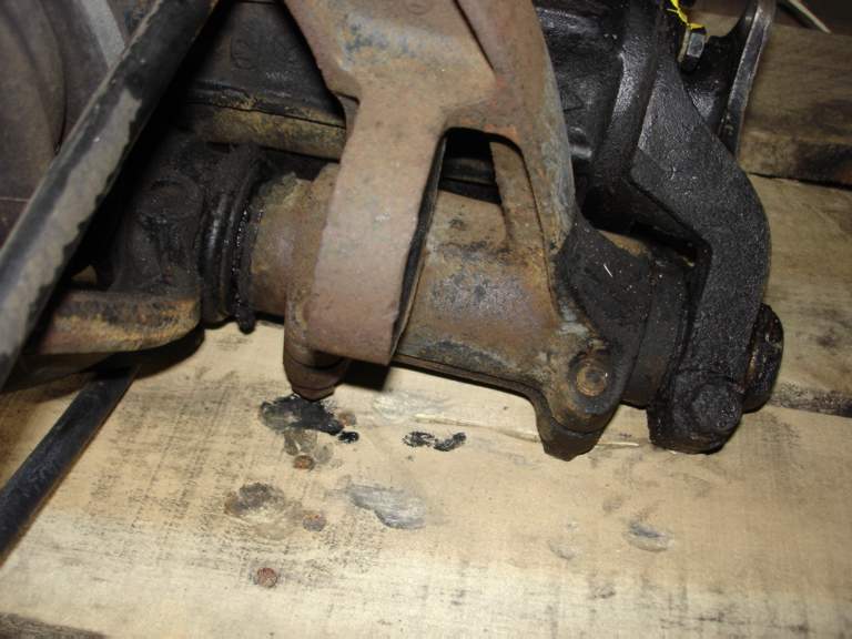

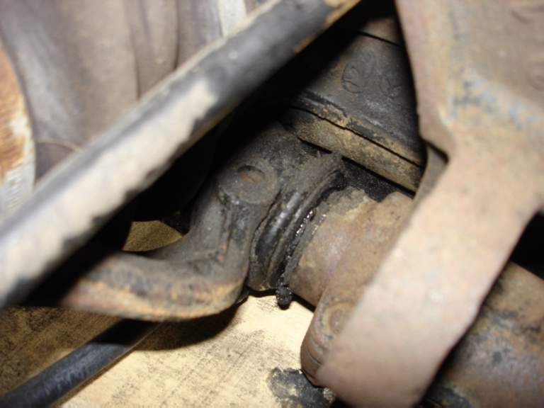

(2) The differential hanger/mount is a big unknown to me. Any suggestions?
Download Attachment: diff_hanger.jpg
54.07 KB
Download Attachment: diff_hanger2.jpg
38.39 KB
(3) It seems that the e-brake cables and attachment points are still intact. How can I check to make sure they are usable and safe? (and thereby obviating the need to remove and replace them from the drum assembly)

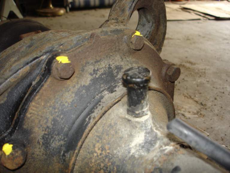

(4) What in the world is this little pipe sticking up in the air? It has a little cap on top, which seems somewhat loosely attached. Anything to worry about?
Breather tube to release pressure build up (from heat?) in the differential.  It must be kept clean.  Rumor is that if this is plugged then fluid will come out the pinion seal.

The rear hanger is easy to check when the rear diff is out by checking the lateral play grabbing the hanger arm at top and rocking foward/backward..
 These are often over-looked  [ vs the often changed top support one in the trunk mount]..
 .if the front seal shows evidence of long time leak/seeage, then the rubber in the support is shot.
 The other reason to check these is cuz the first ones were a two piece rubber inset.  They were later changed/modified to a single, much better full length support. The ratio on yours may be found on a machined flat just in front of the lower/front, outer/left axle
tube mounting bolt.  The first series of #'s will be the serial and the last 3 will be the ratio.. they will use a comma on the ratio #, vs a colon as commonly used here in the USA.

You don't have to pull the axel if you use a split boot. If you split the axel in two you will find out just how much work that is and how tricky it is to do it. The slip coupling also has to be removed before you can take the hinged side off.
You can install the split boot without removing anything although is easier to do this with the cpmpensating spring removed.
