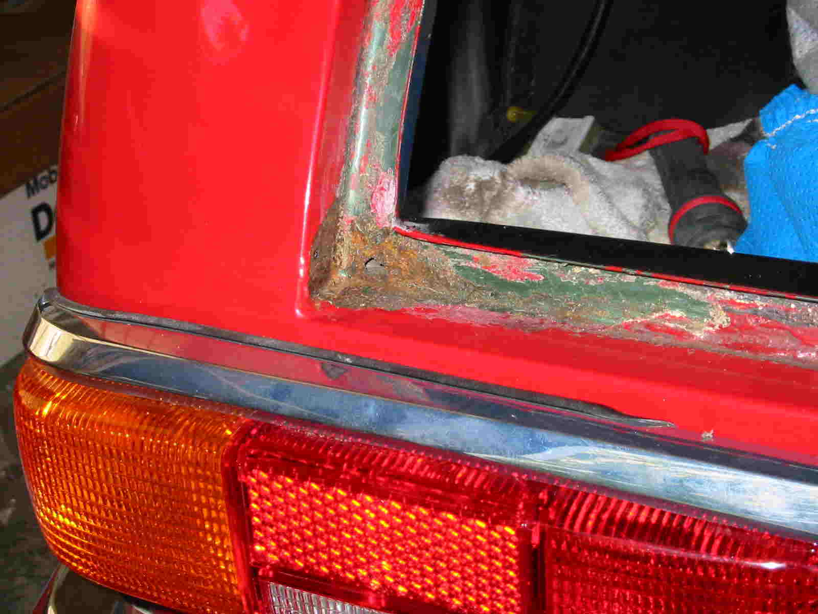

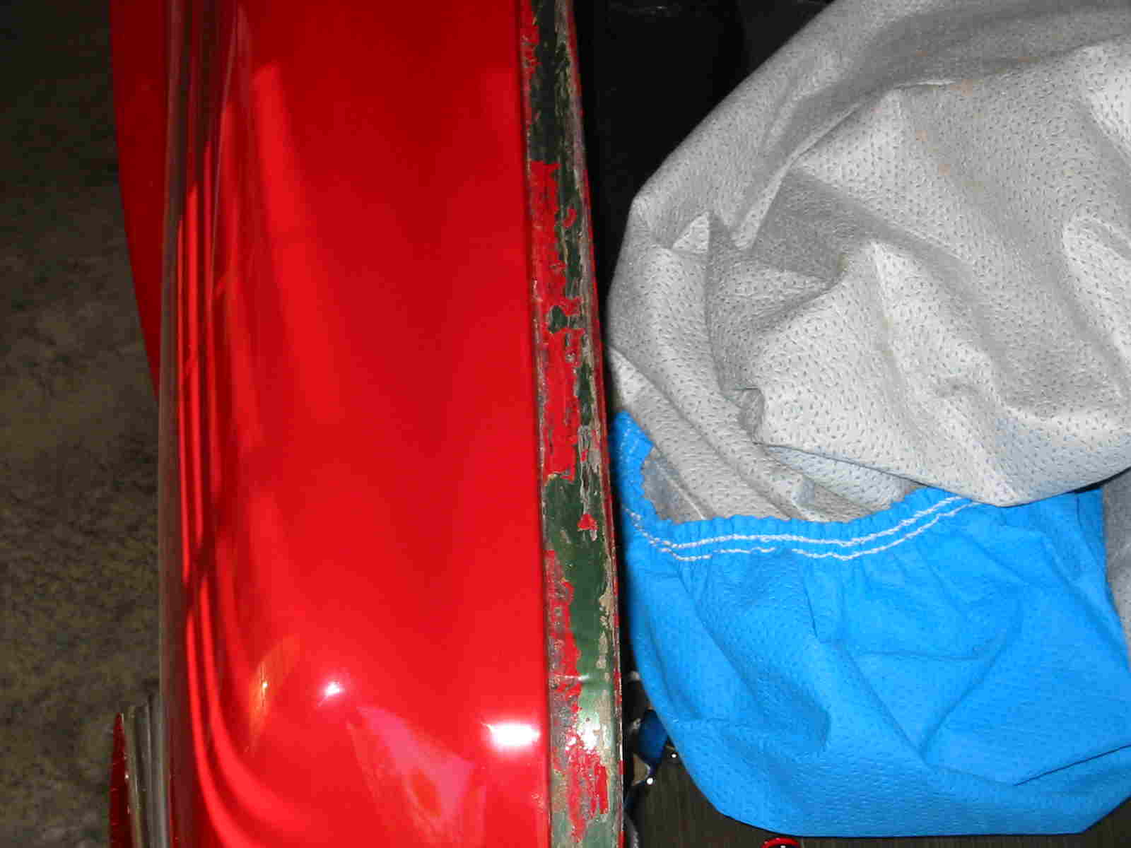

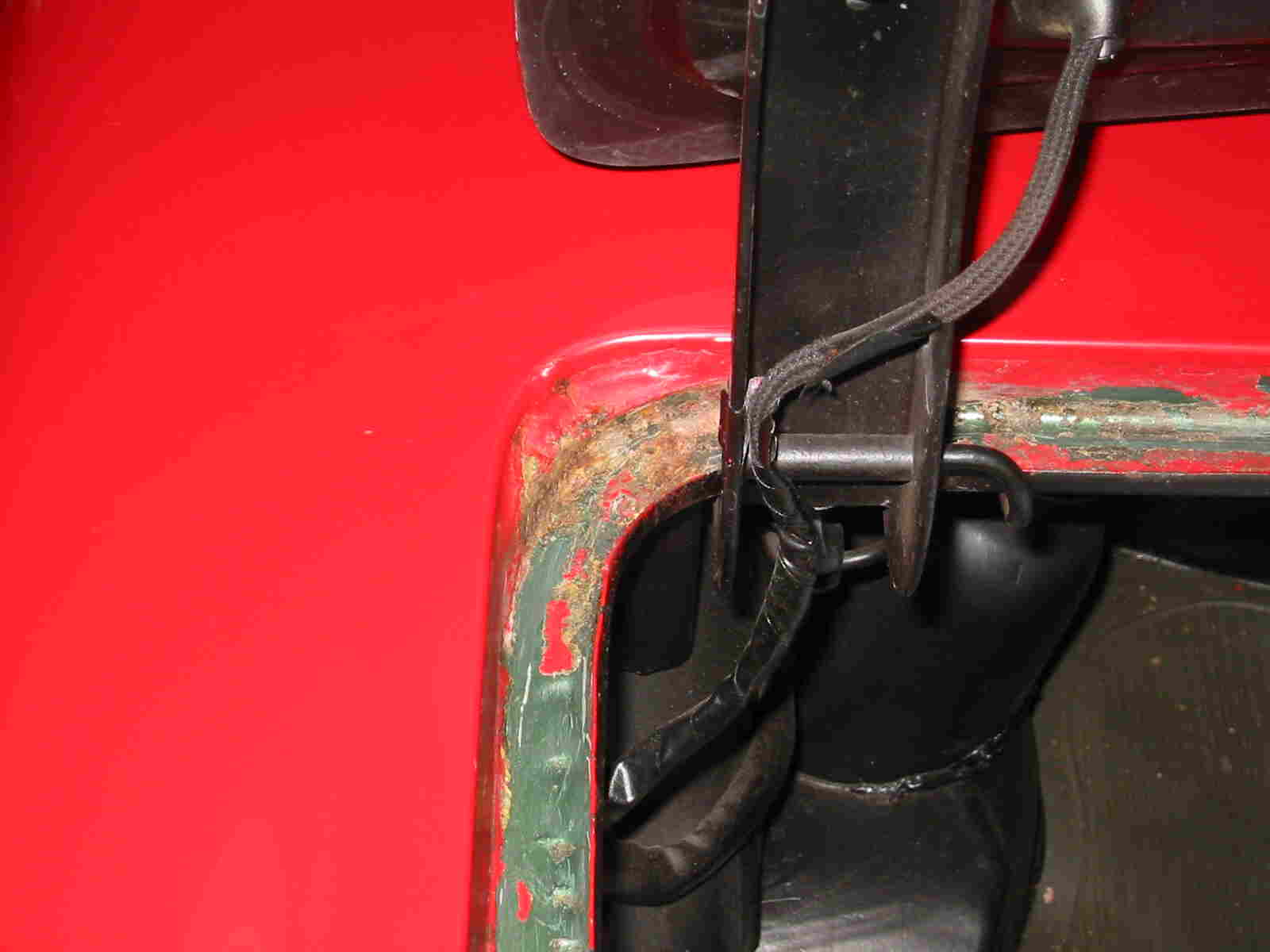

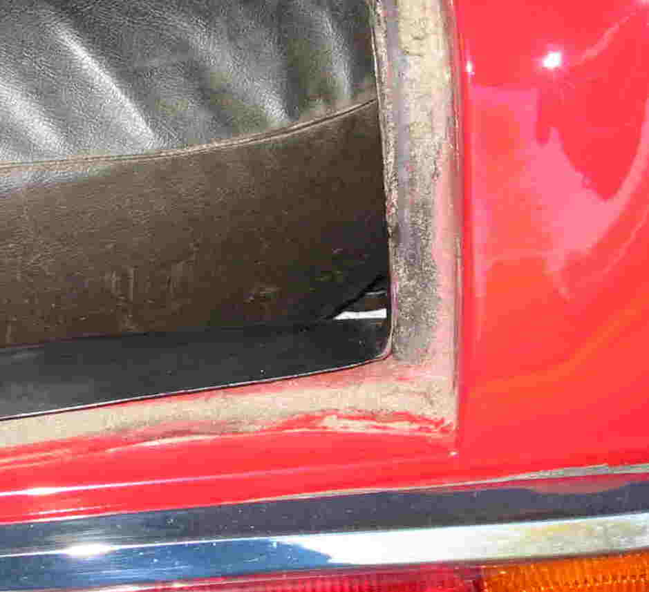

Guys,
Here's my deal.   I removed the trunk rubber seal and found rust in the channel that holds the stripping.   The question is whether this is a repair that can be achieved with a scalpel (that is, spot sanding/repair with minimal painting) or will it require a hatchet (major sanding, major repaint).
Here's the history revealed in the attached pictures:
Original color green - last owner painted red (a $2,400 paint job in 1987).   Trunk channel had rubber seal on top of adhesive, on tope of red paint, on top of considerable original adhesive(!!) on top of original green paint.   Result is soft paint and adhesive "goo" that I'm removing with a wooden chop stick!   In addition, moisture clearly got under the soft/cracked paint beneath the rubber and was trapped.
Car got Ziebart in early 80's following some underbody rust repairs...other than this, rust is minimal.
So, the question is can this be fixed as a minor "spot" repair or do I have extensive work/paint ahead?

Malc
Re: Rust Advice
« Reply #1 on: April 18, 2005, 04:52:29 »
In regard to rust you really do not have a lot of choices. My personal plan of attack in regard to "your" rust and paint situation is as follows, other may go about it in a different way, and that maybe as good, but I have found that this works....
  • Remove boot lid (Trunk lid)
  • Remove everything from the boot (trunk).
  • Remove tail lights especially LHS
  • Mask off the seal channel,double up the masking tape. Then tape on some old blankets or similiar.
  • Dry grit blast the seal channel, use a fine grit for a smoother finish
  • Patch any holes, either metal or "bondo", up to you. [:p]
  • use a good quality etch primer to paint bare metal.
  • Finish in the appropriate colour
From your pictures the Lower Left Trunk Rust is the worst, with a possible hole in the metal.
If your careful you should not have to paint the whole car.
Using grinders, disks and other systems tends to remove metal as well as rust, and usually leave rust behind. "Paint on" rust converters convert from one form of iron oxide to another which has no structural strength!!
You would need a "syphon" type of grit blast gun and access to a compressor. In the UK Sealey Power Products make a good "DIY" gun SSG9EV2 I am using this successfully on the BMW Csi I am slowly restoring.
In the USA companies such as "Sandyjet" make them.
You need to wear protective gear when doing this, Googles and a dust mask at the minimum!
Maybe this is abit over the top, but having "done" an MGA 8 years ago I have had no rust "breakouts" since and it is driven in all types of weather
HTH

Re: Rust Advice
« Reply #2 on: April 18, 2005, 19:35:11 »
Malc is correct for a permenant repair. However cleaning the area up and coating it with something will keep it from spreading for a while.
Try "The Eastwood Company" (eastwoodco.com) they have an extensive line of restoration products, and information. Their catalog is great. They were also a contributing sponsor (products) for our last Ohio Tech Session. Be sure you mention the W113 Pagoda Group.
« Last Edit: April 18, 2005, 19:35:51 by ja17 »
70chevelle
Re: Rust Advice
« Reply #3 on: April 20, 2005, 12:59:24 »
I agree with malc, but you can remove rust with grinder disks, wire wheels, etc. and then use a "rust convertor" or "metal conditioner" as added protection.  It's your choice how you get back to "shiny" metal, and how you repair any holes that are going to appear.  I would not recommend using "bondo" to repair any hole.  Body putty should only be used as a skim coat to cover small imperfections in solid metal. ;)  Seriously, body putty is like a sponge.  If bare putty is exposed to moisture, the paint will bubble quickly.  If you want a chance of the rust not returning, there are a few solutions.
           1)  Sandblast/grind to shiny metal removing all rust from top & underside of channel.  Repair any holes. (Weld, paintable seam sealer, anything waterproof)  Use a metal conditioner (usually phosphoric acid solution) to keep any rust you didn't grind or sandblast from spreading.  Spray with epoxy primer.  (wears like iron)  Spray paint.
           2)  Instead of metal conditioner you can spray self-etching primer, and then paint.  The self etching primer has rust inhibitors in it, but it is not as durable as an epoxy primer.  Most epoxy primers can't be sprayed over etching primers, so you have to pick one way or the other.
Either way will work, but the prep work is the most important.

Re: Rust Advice
« Reply #4 on: April 20, 2005, 22:02:50 »
Here's a totally different take on this.
 If the trunk floor has serious rust problems remove the whole pannel and weld in a new one. It's quite a bit of work but probably no more than trying to clean up years of rust on a fairly thin part to begin with.
You definately want to remove the fuel tank before you even think about grinding or welding in this area. Cutting out and grinding will take up the most time but you have to remember that ANY part of this car has structural importance. This is a unit body car and even the trunk floor is critical in an accident.

Re: Rust Advice
« Reply #5 on: April 21, 2005, 06:44:29 »
From the pictures, it seems that the rust issue is the slot that the weatherstripping fits in, and not the trunk pan.  Some good prep work, elbow grease, and reinstallation of the weatherstripping it should look brand new.

Re: Rust Advice
« Reply #6 on: April 21, 2005, 19:55:51 »
Thanks for the input.   After consulting my trustworthy mechanic and his recommended body shop, here's what I've decided to do of the following three options:
Option 1:   Strip the entire car to bare metal for $10,000.   Maybe when my 11 year old is done with college...
Option 2:  Repair the channel with metal which will require repaint of everything rear of the door for $1,400 to $2,000.   I'm OK with this, but I'm concerned with putting one more coat of paint on this fearing that the current layers will only deteriorate leaving me with only short term satisfaction.
Option 3:  Seal the rust, repaint the channel and a couple other "gimme's" for about $400.
Conclusion:   Option 3 for $400.    Here's why:   All visible paint is quite good and I want to avoid messing that up.   Paint is limited to the invisible spot under the seal
This way, if I don't like Option 3, I'll pursue Option #2 and for the difference, I'm willing to risk $400.
Thanks for the guidance.   Everyone touched the various options in one way or another...However, I now have a new perspective on bondo  [:0]
