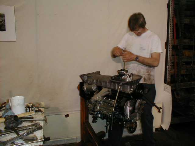

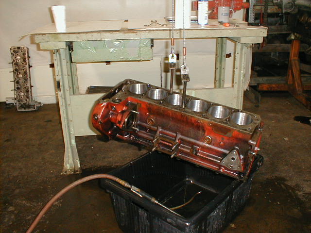

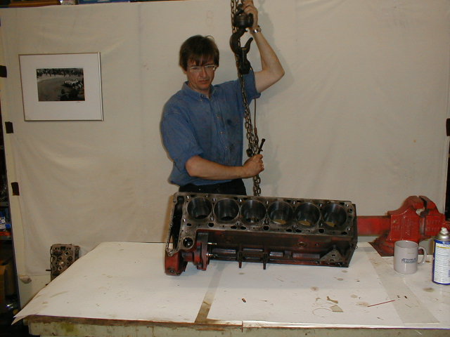

Hello Group,

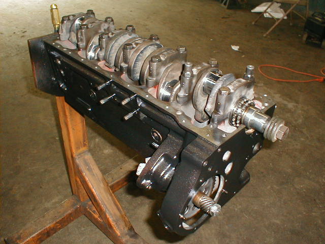

These pictures were taken Tuesday evening. The freshly machined crankshaft is ready for installation. In the next picture, Cees carefully torques the crankshaft with it's new main and rod bearings. All the main and rod bearing clearences were checked with micrometers and plasti-guage before final assembly. We worked till 3:00 am, since case is returning to The Netherlands on Thursday morning. Stay tuned for the completion.

Hello Group,
Lots to do on the last evening. Since I do have another full time job the work is being done in the evenings. Cees has been cleaning and preparing parts in the days along with helping in the evening.
Download Attachment: P1010068.jpg

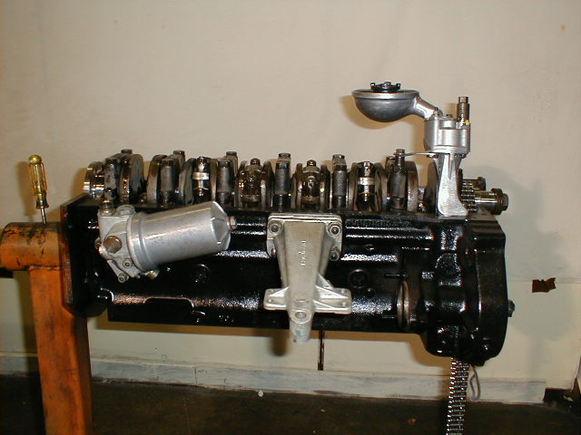

62.6 KB
The engine block with new  oversize rod and main bearings fitted to the now installed, ground to facory specs crankshaft. The engine cylinders were bored-out to 2nd oversize to remove all wear.

59.54 KB
The new pistons, rings, oil pump, timing chain, and many more parts have been fitted to the engine assembly.

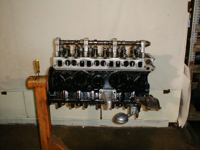

56.81 KB
The reconditioned cylinder head with all new valves, valve guides,  and valve seals has been installed.

57.1 KB
Finished! 2:00 am again! The engine complete with injection pump, will be on its way back to Europe in a few days. Cees will have to drive 350 miles to Chicago tonight to catch his flight to The Netherlands the next day!

Just made it back to Amsterdam. Just some more bits of information which typically interests Pagoda owners:

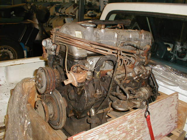

« Reply #10 on: June 14, 2003, 07:05:37 »
The original condition of the engine before tear-down!
