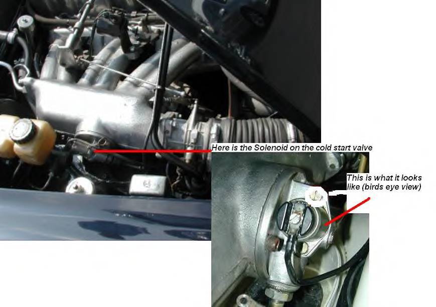

The "Intake Starting Valve;  this device on the intake manifold near right  fender is most often called the "starting valve" in the BBB. It is also referred to as the Cold Start Valve (CSV). This device consists of a electrical solenoid and a valve which allows extra fuel to spray into the intake manifold at specific temperatures for starting. Here is some one's nice photo with text added by "iceberg" of the "intake starting solenoid". The W113 cars had two different size "intake starting valves" one was physically smaller.

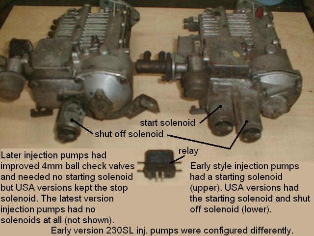

The "injection pump fuel enrichment solenoid", was mounted on the rear cover of the injection pump. It is simply an electrical solenoid which moves the rack in the injection pump to full rich during certain starting conditions. It receives it's positive current via  relay I.  A second "shut off" solenoid (below the fuel enrichment solenoid) was added to the back of the injection pumps in later years it was not a starting aid. The last version, 1970 and later, had no fuel enrichment solenoid at all.  Don't confuse the "shut off" solenoid on these models. Bosch had re-designed the ball valves in the injection pump and changed the intake starting valve so that the injection pump starting solenoid was no longer needed for starting.

b]Download Attachment: icebergs photo of intake cold start valve.jpg
64.48 KB
The easiest way to test these units is to use a test lamp on the electrical terminal of the solenoid during the engine starting process. If power is not delivered during starting, the electrical relay is not working or the "thermo time switch" is defective.

Download Attachment:[/b] injection pump sol.JPG
60.08 KB
The very latest 280SLs were equipped with injection pumps with no injection pump starting solenoid. However, some of these injection pumps may be equipped with "fuel shut off solenoids". Be careful not to confuse the two. I will try to post pictures of the different configurations. The later BBB offers a lot of information on the later replacement pumps (later BBB 07-11/2 through 07-ll/6, and 07-16/1 and 07-16/2).

The diagram you provided shows a single solenoid on the injection pump.  This is the case with my 1970 280SL.  It is my understanding that this solenoid is the fuel shut off solenoid which is activated by the emissions system.  If correct this leads me to believe that I do not have a FIP starting solenoid.  Is it correct to say that only those FIPs with two solenoids have a starting solenoid?

JEFFC280SL wrote: "The diagram you provided shows a single solenoid on the injection pump. This is the case with my 1970 280SL. It is my understanding that this solenoid is the fuel shut off solenoid which is activated by the emissions system. If correct this leads me to believe that I do not have a FIP starting solenoid. Is it correct to say that only those FIPs with two solenoids have a starting solenoid?"
ALL W113 CARS HAVE A STARTING SOLENOID ON THE BACK OF THE FUEL INJECTOR PUMP EXCEPT FOR LATE 280SL's. HENCE, A LATE USA 280SL WILL HAVE ONLY A FUEL SHUTOFF SOLENOID AND A LATE NON-USA 280SL WILL HAVE NO SOLENOID.
However Jeff, there are many earlier models with only one solenoid on the back the FIP...but these are starting solenoids.
