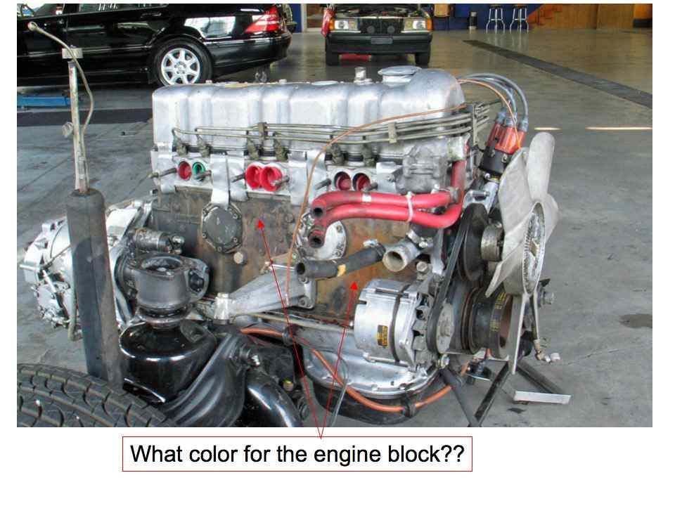

While the engine and transmission are out I am planning to spruce up its appearance. Nothing major, such as CAD plating etc (since the budget is already stretched  :( ), but polishing and spray painting.
The engine block needs the most attention and I was wondering what color to choose? Any suggestions, or  pictures of a properly restored engine are most welcome. Thanks!

Hello Alfred,
The original color was a "low sheen" black. Semi-gloss black is very close and will look good. Please take some time to get rid of those red water hoses! Some original Mercedes black hoses and original style hose clamps would be a nice addition while the engine is out.

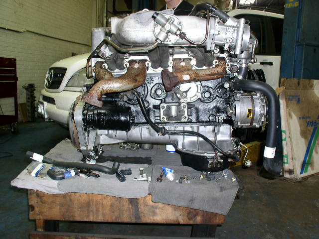

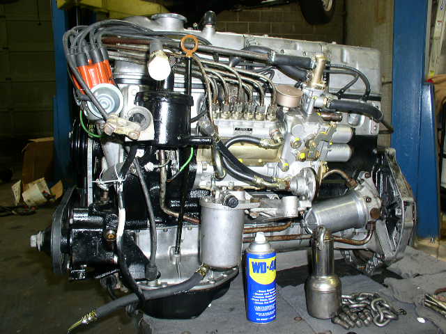

kbailey
Re: Engine block color?
« Reply #7 on: July 22, 2006, 15:09:14 »
I have had mine done to original specs. Black with silver. I expect to continue driving mine daily 8) .  The 280 was not built as a showmobile, but was great looking for its pure function and intentional power plant upgrades from earlier siblings[:p].  (The red hoses did make me squint :x .)  But take that from a guy who is sitting on a seat with a 2x4 under it because I'm getting ready to fix the broken bracket...[:0]  If we didn't have something to look forward to, we'd have new cars and nothing to talk about :) .
Download Attachment: RightSide.jpg
78.54 KB
Download Attachment: LeftSide.jpg
68.08 KB
KBailey
