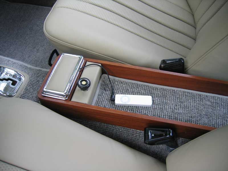

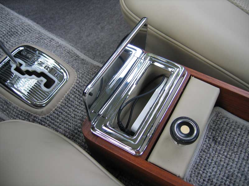

One thing you need to realize is, when you plug something into the Becker supplied DIN cable, it becomes the (only) source. In other words, if you connect a cable to the DIN and run it under the carpet to say, the ash tray or console box, you will only be able to use the device (such as an iPod) that connects to that cable.
To tune in stations on the radio, you would have to reach up under the dash, find the DIN and disconnect the cable that you've run under the carpet to the console area. Painful for frequent use.
I did this same thing and, as a result, use only the iPod as a music source - which is perfectly fine with me- I prefer it that way - just thought anyone considering this should understand how it works.
Download Attachment: iPod2.jpg
61.45 KB
Download Attachment: iPod1.jpg
45.83 KB
Also, the newer iPod Shuffle is much smaller than the one I use and shown in the photo. I removed and stored the original ashtray, bought a new one, covered the lid in the same leather, cut out the snuffer, drilled a hole in the bottom and lined the interior of it in leather. Sounds like a lot of work but not really that difficult. My iPod shuffle lives in the car (ashtray) and is always there when I am ready for some music. The volume is controlled by the Becker volume knob but that is really all I use the Becker for, except to appear period correct.  ;)

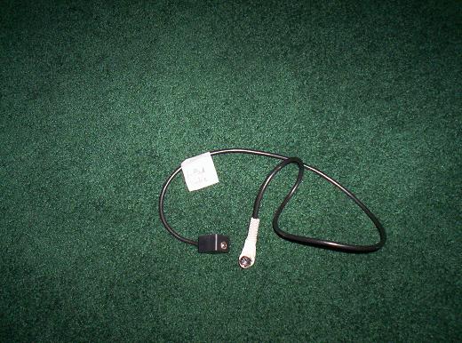

Here is what the one I have looks like. Obviously I haven't plugged it in yet...No Ipod! However, my daughter just got an Ipod Nano (little dinky thing) for her Birthday. She's all of 10 and has me out-gadgeted already!. Do you suppose it will work with this?
PS it is aprrox. 34" long

That's the same cable I have.  It works very well on my Europa II stereo radio.  The small box with the mini plug has the contacts inside that disconnect tuner audio from the Becker amp when you plug in you Ipod or Cd player.
If the cable is too short for the location you want to put the mini plug you need to cut the cable and splice in an extension.  If you try and use a pre-made mini stereo extension cable your radio will not work when you unplug the Ipod.  The contacts for disconnecting and connecting the radio are in the Becker cable end plug.  I hope I'm making myself clear.

Any photos of your ashtray set-up?

All of the Becker supplied cables discussed in this thread that I have seen have a DIN plug on one end that goes into the back of the radio and a small box on the other end with a female plug. Since you plug a male into both the iPod and the Becker cable the cord you suggest below should be 3.5mm male to male.
The photo attached to the original message of this thread tells the story best....http://sl113.org/forums/index.php?topic=5249,DIN,cable
