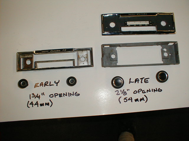

Here is a picture of the early Becker 1 3/4" wide escuteon plate and the Becker 2 1/8" wide later escuteon plate. Notice the early and late knobs also.
Download Attachment: Becker .jpg

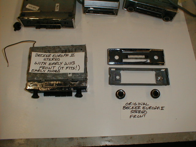

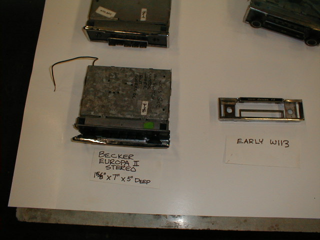

I have some additional radio information and pictures. These Becker radios got a lot smaller over the years. I just took a Becker Europa II Stereo and removed it's escutcheon plate and installed an early W113 escutcheon plate. It fit. Notice from the photos that the earlier knobs fit also. There  is a little extra space around the preset buttons which must have been larger in the earlier models. Notice that I did not have the plastic filler pieces for the early small escutcheon, however they would install fine if I had them. It looks like the whole radio will install from the front! Review the specs. I will also give some information on some of the other Becker models, cassets etc. soon.
The late escutcheon, face and knobs and the early W113 escutcheon and knobs
53.36 KB

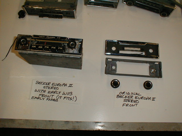

A later Becker Europa II Stereo (very compact!) along side early W113 escutcheon.
Download Attachment: Becker2.JPG
53.15 KB

The early W113 escutcheon actually fits, notice a little extra space around the preset buttons.
Download Attachment: Becker4.JPG
55.84 KB
The entire compact Becker Europa II Stereo should install from the front, even on the early W113 cars with the small opening! Early knobs can be fitted so the unit looks original  with the exception of a little extra space around the preset buttons. The dentification bar "Becker Europa II" can even be switched if desired
Download Attachment: Becker5.JPG
