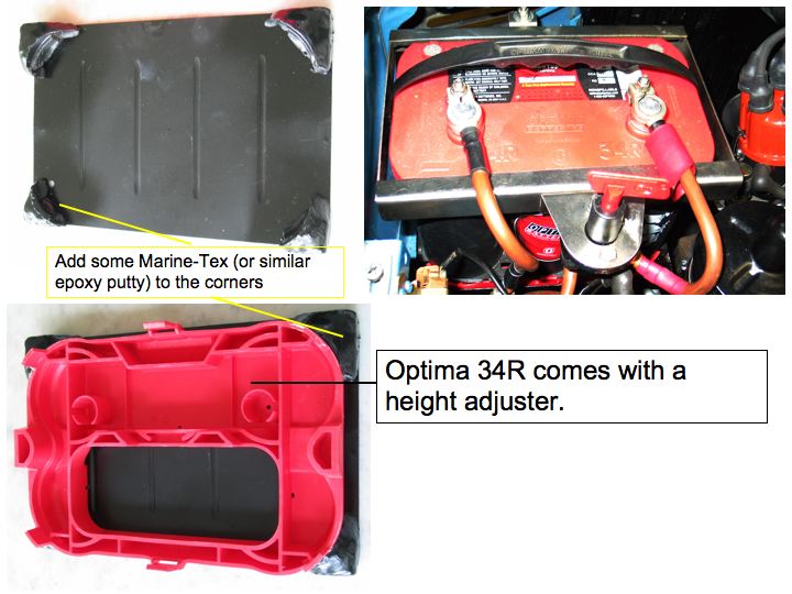

« Reply #11 on: April 26, 2008, 12:09:10 »
The Optima 34R comes with a height adjuster and fits perfectly but its foot print is a little smaller.  To prevent side movement I put a bit of molding epoxy putty (Marine-Tex) in the 4 corners on the tray and painted it black.  My top bracket is different because of the added shut-off switch but has the same dimensions and J-bolts as the original.
No more worries about overfilling and/or leaking battery acid!  :)
