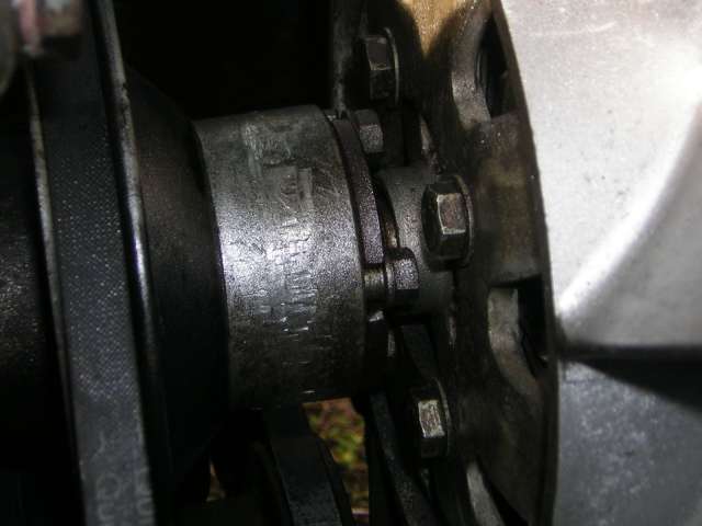

I have the water pump, but on inspection it seems that I may have been sent the incorrect pump. From what I can see, my pump has 4 bolts equally spaced attaching it to the fan assembley and as mentioned in the posts below. (See my photo of the existing pump). However, the one I have been sent has only 3 holes (see photo). Can anyone shed any light on this? I gave SLS my engine number so they should have sent me the correct item.
It's my opinion that I have the wrong pump, but before I send it back and order another, I just thought I'd ask for a second and better informed opinion!
Thanks,
James

The pump you received is correct for a 230SL: it did not have a fan with viscous coupling. If you want to continue using the viscous coupling, then you'll need a pump from a later car (250SL/280SL) which has the four bolts like your current pump.
The fan in a 230SL has 4 blades and is bolted on directly to the water pump with three bolts. The original 230SL fan was some kind of metal alloy, whilst replacements are white plastic.
Whenever the switch was made to the viscous coupling, the fan was made out of metal and now had 6 blades. The viscous coupling was what was actually bolted on to the water pump now using 4 bolts. This setup is all I've ever seen in 250SL and 280SL cars.
« Last Edit: June 02, 2008, 11:50:23 by waqas »

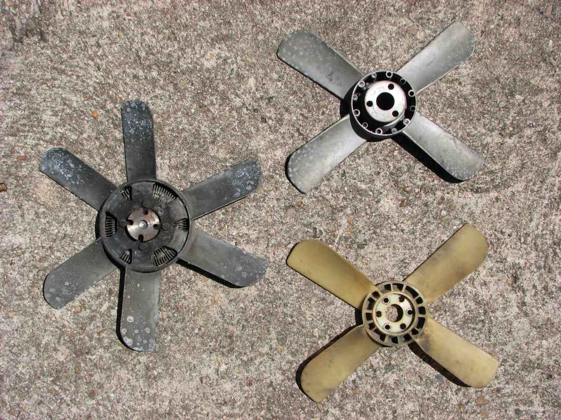

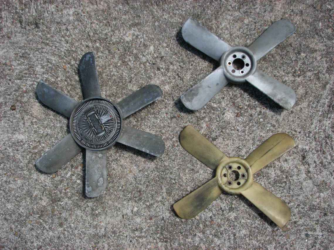

As promised, here are pictures comparing the three types of fans (front and back): plastic 230SL fan (4-blade), metal 230SL fan (4-blade) and metal 250SL/280SL fan (6-blade).
Normally one shouldn't store the viscous coupling horizontally, but I've no intention of reusing this one.
Download Attachment: IMG_4981-smaller.jpg
144.48 KB
Download Attachment: IMG_4983-smaller.jpg
165.69 KB
The plastic 230SL fan has the part number 180 205 09 06 cast in the centre hub. The 250SL/280SL 6-blade fan has the part number 108 205 10 06 cast in the centre hub. I couldn't find any part numbers on the metal 230SL 4-blade fan.
Also, notice the four bolts on the back of the 6-blade fan that hold the fan onto the viscous coupling.

Notice how the 6 blades are not symetrically spaced around the hub.
Bob Smith (Brisbane,Australia)
