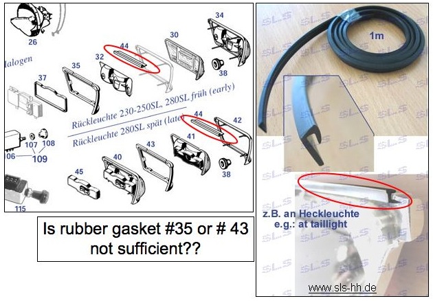

As long as I have the car I am trying to prevent water leaking around the left tail light into the trunk. In an earlier post Bob Possel suggested to replace the outside rubber gaskets around the light (#35 in the picture). Although this improved the problem it did not fix it totally. So here are my questions:
1.  How hard can I tighten the 4 nuts on the studs that protrude inside  to press the gasket as tight as possible against the chassis before I can do damage?
2. SLS shows the use of additional weatherstripping around the tail light. Has anyone used that strip and if so did it help?
My 230SL parts book doesn't show that strip so it may be something SLS is suggesting to cure a known problem.

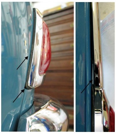

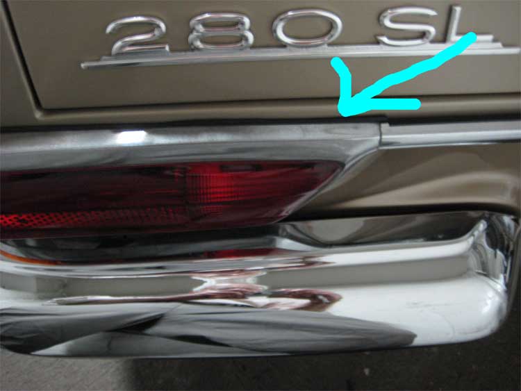

The original rubber strip is NLA from Mercedes or from the US parts places so let me put in a bid for a piece of your unused strip if you get it from SLS. One of my lights is missing the strip.
Here's a photo of one light with the strip and one without (Sorry for the jerky picture.)
Richard M, NYC
Download Attachment: RearLT2.jpg
31.1 KB
Light unit with Strip.
Download Attachment: RearLT1.jpg
27.19 KB
Light unit without strip. The Left arrow is pointing to the strip on top of the chrome bar below the trunk lid.

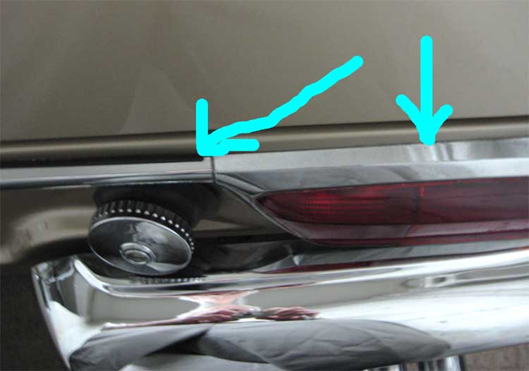

Originally posted by waqas
In three different cars, I've pulled apart the lights and found the rear lens section was actually attached to the body first with nuts and washers (on the same bolt stems)...
Waqas,
that is exactly how they were mounted on my car (see picture) and that was my first question. How hard can I tighten these nuts? Obviously the seal on the outside is determined by the pressure you put on these studs.
Are 280SL lights mounted differently?

Doing the dry fit first I noticed a significant gap between the chrome trim on the outside lower left front edge. What helped closing this gap was to tighten the lower left nut first, that pulled in the edge. Next the upper left nut which pulled in the remaining vertical part [see picture on the left]. After that I tightened the other two nuts and did your hose test. Voilà- no leak! 8)
But now I do need to install that strip behind the chrome trim that connects the light with the lock since the rubber gasket is clearly visible.  There is too much of a gap between the trim and the paint. See picture on the right.  (I put a piece of paper underneath to show the gap more clearly)
James, yours probably has that strip because the replacement lights are 2-component units as the good Dr. pointed out in the earlier discussion:  [http://sl113.com/forums/index.php?topic=1350].
Did you also add the strip behind the chrome trim?

I'm easily confused by something as technical as a strip of rubber but when I compare the strip in the parts diagram to the piece on my car, I see a difference.
The one on the car (maybe original??) has a "bead" shape along the top of the light, a kind of half round profile. The strip in the parts diagram seems to be flat along the top.
Here's a (poor) photo of the light unit with the "bead" strip and the strip on the chrome bar next to it. The piece on the top of the light is rounded while the chrome bar strip is flat.
So maybe the new strip is a replacement with a different profile...might work to keep out water but in my case it won't match the older strip. I believe the rounded older strip is NLA. I guess a new strip could be put on both lights to have them look the same.

And to complicate matters further, the strip that SLS sells for the tail lights is NOT the same that they sell for the trim piece.
Another possibility is to buy p/n 000 987 73 70.  This is a part used to seal the fender moldings on a 112 coupe/cabriolet against the body. In contrast to the original part it is a plastic that is both stiffer and perhaps a bit thicker. But it is still available from MB at about $6 - 7 per meter.
