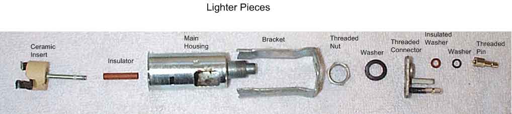

I'm working on getting the lighter out. I have the nut loose, the connector end impedes its removal.  I'm unclear whether it "pops off" or has to be screwd off.
Also having truble removing the left of the three escutcheon nuts.  I can get a 11mm ratcheting wrench on it and it isn't budging with significant pressure.  I dripped some penetrating oil on it for the night.  Other ideas?

Hello bjudd,
Look at the attached pic of the pieces of the lighter.  Note the pieces that are "threaded".  Hopefully this helps with removal and then reinstall.  Make sure to install as in the pic.  It is important to get the insulated washer in its correct position.
Good Luck!

Bob,
the picture helps immensely.
does the threaded pin come off first or does it slip through the "threaded connector" and come out with the housing and cer. insert?
thanks

bjudd,
The threaded pin is the 1st item to unscrew.  I remove in the order shown on the pic.  Work your way from back to front, back being the pin 1st.
Regards,
Bob
