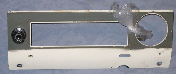

since your car is an early 250SL it is likely that it came with a mono radio, such as a Becker Europa TR.
Before deciding what to buy make sure that your dash board opening was not enlarged for the current radio.
It should measure 1 3/4 x 6 7/8 inches to accept a Europa TR; see: http://www.beckerautosound.com/Classic/Coupe_face_%20vs_standard%20_info.htm
But I would also check the kick panels as Mike suggested to see whether stereo speakers were installed there.
While it is possible to buy Becker TR radios make sure that you get one with brackets for both the radio and the separate amplifier.  For amplifier mounting location and what the brackets look like take a look at this topic:

My next step is to remove the existing radio and measure the opening to see if it has been enlarged.  The previous owner installed a new Sony head unit, so my assumption is that it has (See pic).  I'll then call the guys at Becker Autosound to see what they recommend.  I'll take photos and share with the group.

If you want a European Becker - that is one with shortwave SW (=K), long wave LW (=L), AM (=M) and FM (=U) then your best bet might be this company: http://www.koenigs-klassik.de/_Becker_/_becker_.html. Check out the online shop for available models and prices.
But I am not sure whether you would gain anything from spending quite a bit more money. I am not sure how many more points you would get at a "Concours" show, perhaps Michael does, but to be period correct a Becker TR or Stereo II should be just fine (Stereo models did become available in 1967).
If you do have a larger opening (and it looks like you do) then you can use the Europa Stereo II (that radio has the larger standard DIN opening) and take advantage of the kick panel speakers.  In this case you could buy modern dual cone 4.5" diameter speakers and cover them with the correct speaker covers as shown in these eBay auctions: Item Number 110493026066 or Item number 250568661897.
If you want to be a bit more conservative and stay with a 1967 TR then you'll need to buy a new radio dash plate:
http://www.sl113.org/wiki/uploads/Electrical/230PlateR.jpg
with the correct opening. They show up occasionally on eBay.
