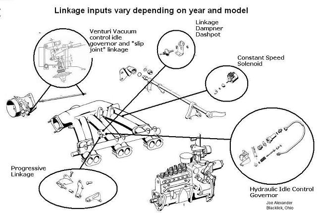

There has been a lot of information posted on the subject of linkage adjustment. Thought it might be nice to have it all in one document with photos and diagrams. I have added factory information and what I know on the subject. Feel free to add, or correct as needed.
Sorry if some of these plates have become fuzzy after compression.

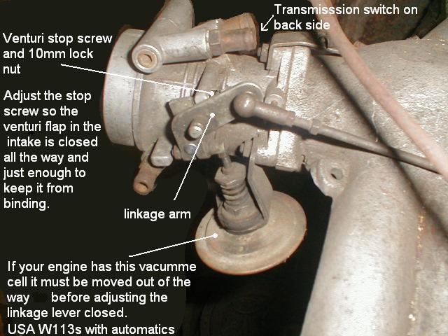

The intake venturi is one of the most  important aspects of the engine linkage adjustment, engine tuning and automatic transmission shifting. When not adjusted properly problems with improper idle speed, hard automatic transmission shifting, up or down and erratic engine behaviour may result. Proper linkage adjustment will be nearly impossible if the venturi is not correctly set.
The intake venturi stop screw.......
The most common and first item to check is the small slotted stop screw with lock nut on the intake venturi.  This is factory set and is frequently mistakenly used as an idle adjustment screw. This stop screw must be set so that the intake linkage arm and venturi valve in the intake closes all the way! When not set correctly too much idle air will be admitted to the engine causing lean idle mixture and/or too high engine idle rpm. An uninformed person may compensate for the situation by tampering with injection and linkage adjustments thus getting the engine even further from being in correct tune.
Download Attachment: venturi illus.JPG
64.5 KB

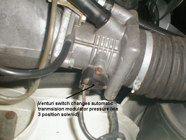

W113s with automatic transmissions also have a electrical switch attached to the venturi.  This switch lowers and raises modulator pressure by activating the three position solenoid on the transmission. Harsh downshifts (especially the last downshift before a stop) may result when not adjusted correctly. Correcting an improper set venturi can make an amazing difference in shifting, engine idle and engine performance.
Download Attachment: venturi illus2.JPG
55.46 KB
Disconnect the linkage rod going from the cross over rod to the venturi. If you have a USA version with the vacuum dash pot, you will need to move it out of the way so it does not interfere with the adjustment. The small slotted venturi set screw must be backed off enough to allow the venturi valve to close all the way and then adjusted in just enough to keep the venturi valve from binding in the intake.
USA 280SLs had an "Vacuum throttle control" on the intake venturi linkage. A special linkage with a "slip joint" was also used between the venturi and the cross-over rod on the engine. Adjust the slip joint linkage so it is fully compressed with the engine running and warm at idle in neutral. Adjust the vacuum control/linkage to
zero clearance. Now with the transmission in gear, the throttle lever will open 1.0 mm to 1.5 mm.
If you have a factory shop manual with the USA versions look on page 07-14/7.  It gives the procedure to adjust the unit.
Adjustments of the other linkage and tune-up items can follow afterwards if the idle is too high or too low or the mixture is incorrect.

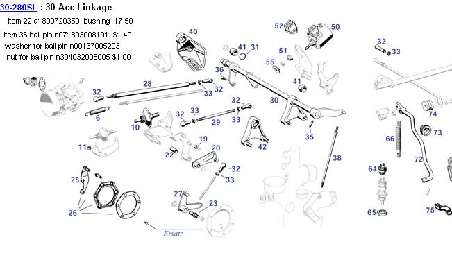

Naj points out that linkage parts should be checked for wear and has supplied parts numbers. Thanks Naj.
127 072 0185 spherical brass bushing (2 required)
000 991 8922 rod end ball socket RHT (as required)
000 991 9022 rod end ball socket LHT (as required)

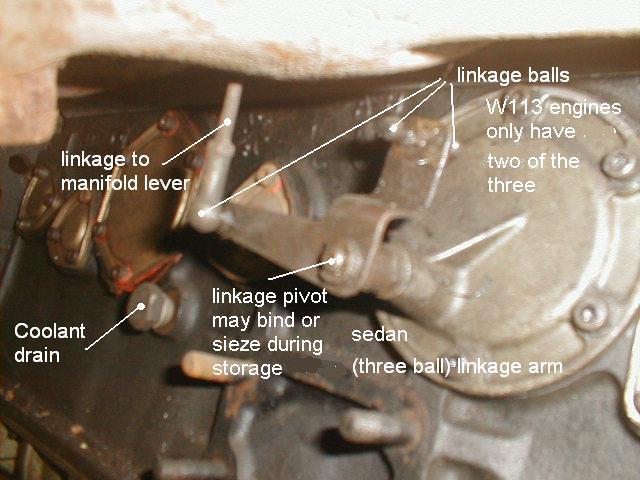

During regular maintenance engine linkages should be lubricated with a light oil. Often times the block pivot is missed and may begin to bind or seize after periods of inactivity or storage. Try using some penetrant first then oil after it becomes free. This photo is a sedan pivot. The location is the same (under the intake manifold) and the unit is very similar. Also not the factory coolant drain plug location in the picture.
Download Attachment: block linkage lever.JPG
53.21 KB

Information and diagram contributed by "merrill" Matt Merrill;
"I have put the part numbers for another linkage bushing, ball stud , washer and nut.
all are available at the price in the photo. the bushings are only in germany"..........
Matt Merrill's information;
Download Attachment: Merrill.jpg
36.73 KB

You might want to include a reminder to check and lubricate the bell-crank on the cooling jacket cover.
66 230sl

Hellow Al,
Good point on lubricating the block pivot.  I will have a photo I will splice into the "tour".

Is there a specific length for the "linkage to manifold lever" (shown in the "Block linkage Lever.JPG" photo), or is it adjusted "as needed"?
Ken
'66 230SL (Euro, 4-speed)
  • Posts: 7469
Re: Linkage Tour
« Reply #13 on: November 16, 2006, 23:49:58 »
Hello Ken,
I have never seen a specific length listed for the rod between the pivot and the manifold, but if it is too short your accelerator pedal may be too high. If it is too long you may not be getting full throttle.  One easy test is to hold the accelerator pedal all the way to the floor (engine off). Next have someone check to see if the venturi is open all the way.

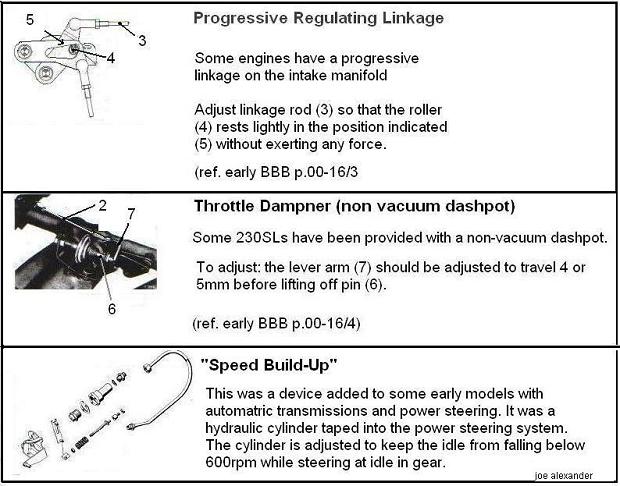

Thanks for the great information!  I have a quick question about the Progressive Regulating Linkage (top diagram in your linkage 13.JPG pic):
Is there supposed to be some play in the linkage when I press the accelerator?  I have the linkage rod adjusted so the roller rests as indicated, however, I have to depress the pedal about a 1/2" or so before the linkage engages (i.e., the linkage engages the roller); is this the correct configuration?  I hope that isn't too vague or misleading?
Download Attachment: parts for linkage.JPG

Thanks for the good added imformation merril,
I will cut and paste it into the original "Linkage Tour" (with a credit to you) so it does not get lost!

Hello Steve,
By the looks of the diagram it appears that the progressive linkage is meant to move a bit before things start to happen, however the "roller openings" do wear and yours may be bit excessive. In this case you may wish to replace the linkage plate or adjust it a bit off the rest to compensate. Make sure you get "full throttle" (venturi fully open) with the accelerator pedal on the floor.
