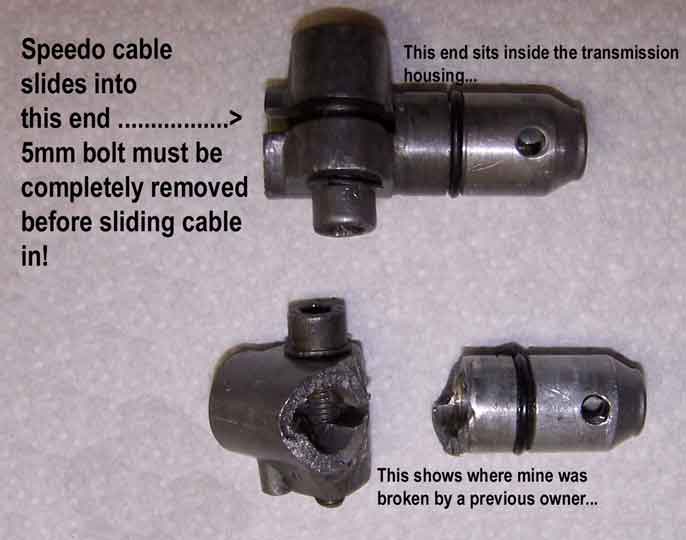

« Reply #3 on: November 19, 2006, 06:58:48 »
Thought this picture may help you see a close-up of the end where the speedo cable attaches to the transmission.  The reason I replaced my cable was because the speedo would periodically bounce while driving.  When I went to remove the speedo cable from the transmission side, I noticed that it was loose.  Turns out it was broken in the area that all have warned about in terms of not over tightening.  So, my simple cable replacement turned out to be sort of a nightmare in that I also had to replace the broken housing along with the cable.
Good Luck!
