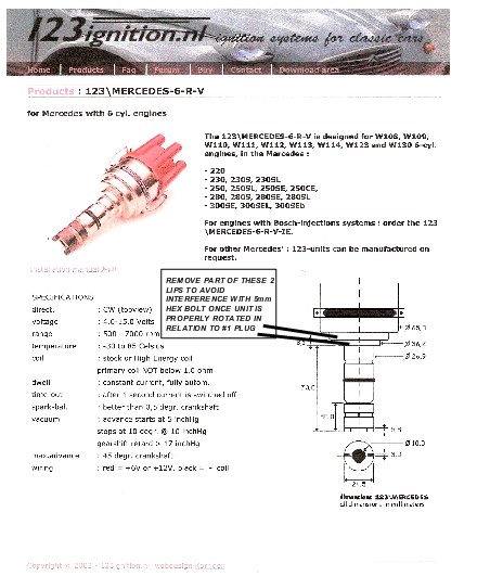

$700 is what it cost me including tax, shipping and modification of the unit. The unit needs a minor modification for our cars. This involves cutting or grinding off part of the "base" of the distributor "cup" where it sits on the collar of the distributor housing upon insertion, in order to avoid seating interference by the sleeve of the 5mm hex clamping bolt. While the unit will still function without this mod, the dog will only partially seat in the drive.

Re: Distributor replacement from 123 ignition
« Reply #22 on: June 01, 2008, 10:06:51 »
Naj,
Thanks for the info.
Nobody else has mentioned having to grind off a bit of the housing...
« Last Edit: June 01, 2008, 10:07:23 by naj »

So is the grinding being done on the 123 unit or the engine?
