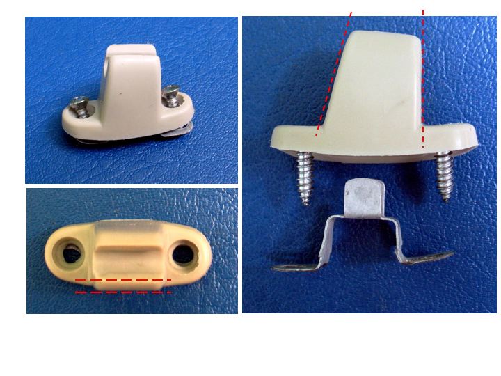

I don't have a pic of the later visor clip but here is a picture showing the 230SL visor clips.
They may be hard to reproduce because one edge is right angle to the base and the other tilted and in addition the top is a bit slanted making the right edge (as seen in the pic) a bit shorter. This is clearly noticeable for the metal insert. I believe (but am not sure) the "front/lower" wall may be thicker and a bit more convex than the "rear/top" wall.

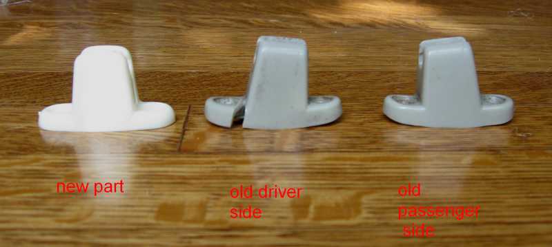

Here's the comparison photo I used when trying to explain to someone what the problem was.  It shows the new (non-functional) one.

Scoot,
Hi.  Excellent picture showing the problem, but could you resize it, or post it as a link or something?  I believe most people find it annoying to have to scroll left/right to read text because of a large photo.

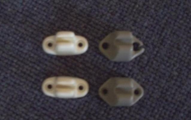

Well, about 3 years ago I purchased new clips from Ray at the old SL Classics. My old ones had two hairline cracks. The new ones looked very cheap to me -- so much so that I decided to use a washer and live with my originals. But ironically, (as to this thread), my old ones just started getting worse.
So, today, I took the old ones off, compared them side by side to the new ones, and then proceeded to install the new ones. Here are my findings:
The new ones are definitely smaller and more generic looking.
Old and new: Download Attachment: clips.jpg
36.7 KB

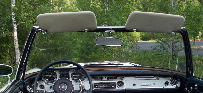

They are almost white whereas the old ones were a light grey. With my car and dash being white, they kind of go with the interior.
Download Attachment: clips2.jpg
72.61 KB
They do fit and yes they do hold the visor in place. If I could get the real deal, I may change back someday but for now they are ok.

OK, now I am _really_ confused.  J. Huber shows a picture of an old-style clip compared with the new ones that is totally different from my picture of the old-style clip as compared with the new one.  We all seem to agree on what the new one looks like, but there seem to be two different old-style clips.  Compare the pictures in the thread.  And compare with the one on ebay that ends in 9 hours.  Item #130232101327 -- I was going to buy this but now I see that it isn't what I need at all, but perhaps it is what one of you need.  I need what is shown in 66andBlue's post.  I don't need what is shown as the first picture in J. Huber's post.   Very confusing....

I kind of see what you mean Scott. The Ebay one does look like mine. And I spent a lot of time trying to see the pronounced "slant" that Alfred's have. Mine is really not so slanted. So I wonder if there was an "early" 230 clip and a later 230 clip. Not really sure. But I may try for the Ebay item!

I am pretty confident that we are still talking about three different styles of clips:
1.  the ones that are depicted in J Huber's post - the first picture showing his old clip and the new MB clip
2.  the ones that are depicted in my post and in 66andBlue's post -- both of these posts show a possibly later version of an old-style clip that DOES have a metal portion inside.  (In case there is any confusion, my clips match what 66andBlue shows, his picture is just better.
3.  the new "replacement" clips available from MB and other vendors which are shown as the new clip in my post and in J Huber's first picture post.
I'm thinking that there is also a later style clip that goes for a 280 SL -- is that correct?
For my car the critical part is the angle of the clip where the visor end meets the clip -- shown quite clearly in 66andBlue's post.  Without that tilt the clip doesn't hold the visor at all.

Hi James,
two distinguishing features of your "old" clip and the one on ebay (that's now yours too  :) ) are the hexagonal base compared to the narrower, more oval base of  your "newer" one, and mine and Scott's.  And I believe the old one also has a straight base while the others are curved.
I wonder whether your old one did not come from a sedan from the same time? I believe that the spot where the clip is attached in the sedans is flat while in ours it is curved and hence the clip needs to be curved too.
Perhaps Waqas can show us what his looks on the sedan.
